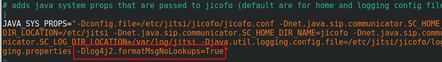

Jitsi Workaround for CVE-2021-44228/LogJam/Log4Shell
You surely heard of the LogJam / Log4Shell / CVE-2021-44228 – if not, take a look at this blog post. If you’re running Jitsi is most likely vulnerable and as there is no fix currently, you need a workaround which I provide here for you. You need to add -Dlog4j2.formatMsgNoLookups=True at the correct places in the file – the position is important.
/etc/jitsi/jicofo/config
/etc/jitsi/videobridge/config
And restart the processes or restart the server.

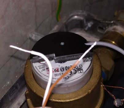

In the village I live the water meter is replaced every 5 years and it was the fifth’s year this year. I took the opportunity to talk to the municipal office, if it was possible to get a water meter with impulse module, which I can integrate in my network. And they said yes 🙂 – Thx again!
So last week they came by and put the new one in, I was not at home, and when I came home I found following:
They also left  the packaging, so I was able to guess the module. For me it looked like a “Ringkolben-Patronenzähler MODULARISRTK-OPX” from Wehrle as shown in this datasheet. I was not 100% sure if it was the S0 or M-Bus version, but a friend told me it must be the S0 Version as the M-Bus is much more expensive, so I went for it.

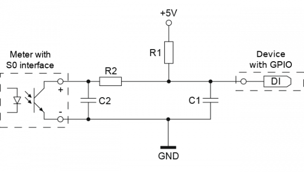

Getting the S0 connected

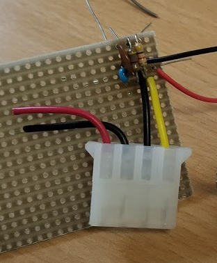

Basically the meter has an optocoupler (optoelectronic coupler) which is powered in my case by an internal battery. At every liter of water that runs through the meter, the two cables shown above get connected for a short period (e.g. 100ms). In the simplest case it would be possible to just use a pull-up resistor to 5V, but this may lead the problems. It is better to use 2 resistors and 2 capacitors stabilize the impulse and guard against unwanted effects such as electromagnetic interference. As my time when I learned that at school is too long ago, I asked a friend who does circuits all the time for help, which let to this drawing:
And he told me to use following resistors and capacitors:
  • R1 – 4,7kOhm
  • R2 – 470Ohm
  • C1 – 100nF
  • C2 – 10nF
At home, I build that circuit (no fully done on the picture):
As you can see I used old PC power supply connectors to connect the water meter, so I can disconnect it easily. Hardware costs under 1 Euro so far – OK need some stuff at home already (e.g. soldering iron) 🙂

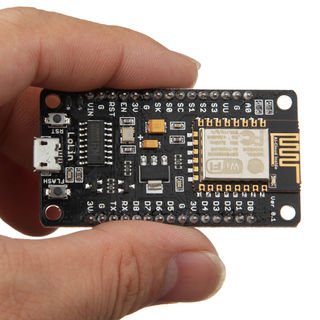

I went for a NodeMCU which has all I needed for that project:
  • Digital Input with interrupt triggering –> no polling and missing an impulse
  • WiFi support to connect to my IoT network
  • Integration with the Arduino IDE
  • It costs under 5 Euro

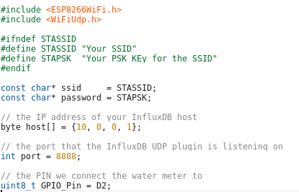

Lets take a look at my code – which you can download from here. In the first part of the code we import the needed libraries and define some variables:
  • The WiFi SSID and password
  • The host and port we will inform for every liter of water – We’ll use InfluxDB for that and you will see how easy that makes it.
  • The PIN we connect the water meter to – make sure it supports interrupts.

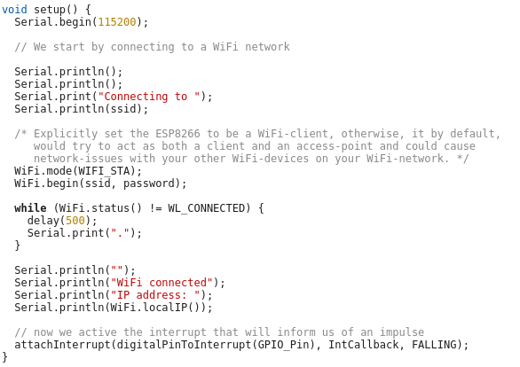

And now the code which is executed once at startup, where we connect to the Wifi and attach the interrupt.

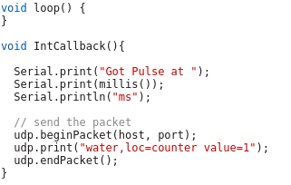

And at last we need the code that gets called by the interrupt – it just sends a UDP Message in the InfluxDB format for each Liter of water, the rest is down by the InfluxDB time series database.
As you see the code is really easy – the complicated stuff is done by the InfluxDB.

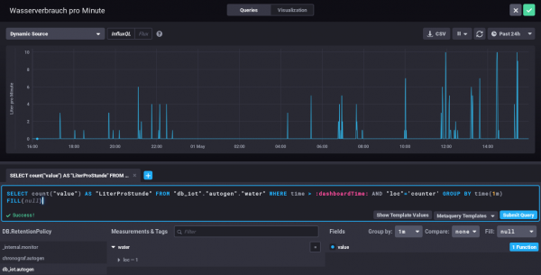

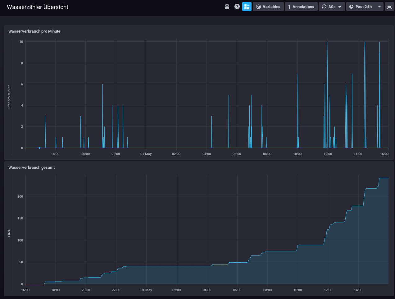

My water meter dashboard looks currently like this:

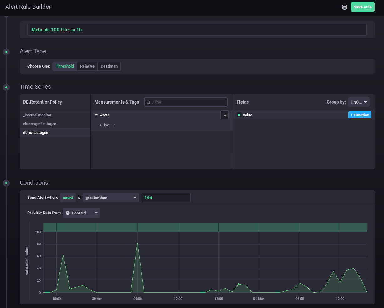

And you can also define alerts. In this case I wanted to get an alert message send, if more than 100 Liter of water is used in one hour – I should know if that happens and if it is OK.
I hope you see how easy visualizing and alerting a water meter can be. It is also really cheap – about 5 Euro for everything, if you’ve already a server otherwise let it run on a Raspberry PI (about 30 Euro), rent a virtual server for 1-2 Euro/month or use the container feature of your NAS.

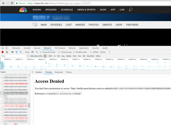

Just a short note. Today a friend called me if I could help him to get TV streaming from TV stations in the US running. When I looked at it, he even selected a VPN provider which offers servers in the US to circumvent the Geo restrictions, but still it didn’t work. He showed me the NBC website where the first ad was shown and than the screen stayed black. Having no experience with VPN providers and TV streaming sites I first checked the openvpn configuration and made sure that the routing table was correct (sending all non local traffic to the VPN). Looked good, so I opened the developer tools in the browser and saw following repeating.
Searching the Internet did not provide an answer … than I just tried to download the file with wget and I got following:
$ wget http://nbchls-prod.nbcuni.com/tve-adstitch/4421/xxxx-1.ts
--2018-08-10 19:20:20-- http://nbchls-prod.nbcuni.com/tve-adstitch/4421/xxxx-1.ts
Resolving nbchls-prod.nbcuni.com (nbchls-prod.nbcuni.com)... 2600:1406:c800:495::308, 2600:1406:c800:486::308, 104.96.129.98
Connecting to nbchls-prod.nbcuni.com (nbchls-prod.nbcuni.com)|2600:1406:c800:495::308|:80... connected.
HTTP request sent, awaiting response... 403 Forbidden
2018-08-10 xx:xx:xx ERROR 403: Forbidden.
Seeing this it hit me … its using IPv6 … so I did a fast check with
% wget -4 http://nbchls-prod.nbcuni.com/tve-adstitch/4421/xxxx-1.ts
--2018-08-10 19:20:30-- http://nbchls-prod.nbcuni.com/tve-adstitch/4421/xxxx-1.ts
Resolving nbchls-prod.nbcuni.com (nbchls-prod.nbcuni.com)... 104.96.129.98
Connecting to nbchls-prod.nbcuni.com (nbchls-prod.nbcuni.com)|104.96.129.98|:80... connected.
HTTP request sent, awaiting response... 200 OK
Length: 242520 (237K)
So with a IPv4 request it worked. His VPN provider was leaking the IPv6 traffic to the Internet – that is potentially a security/privacy problem as many use a VPN provider to hide them! So make sure to check before relying on the VPN security/privacy.
